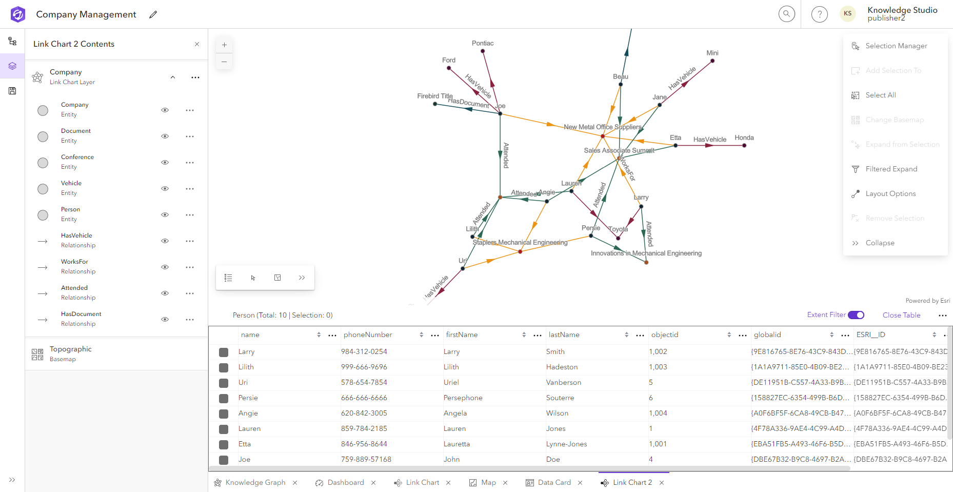

The table appears at the bottom of the view.
Link chart with table open
