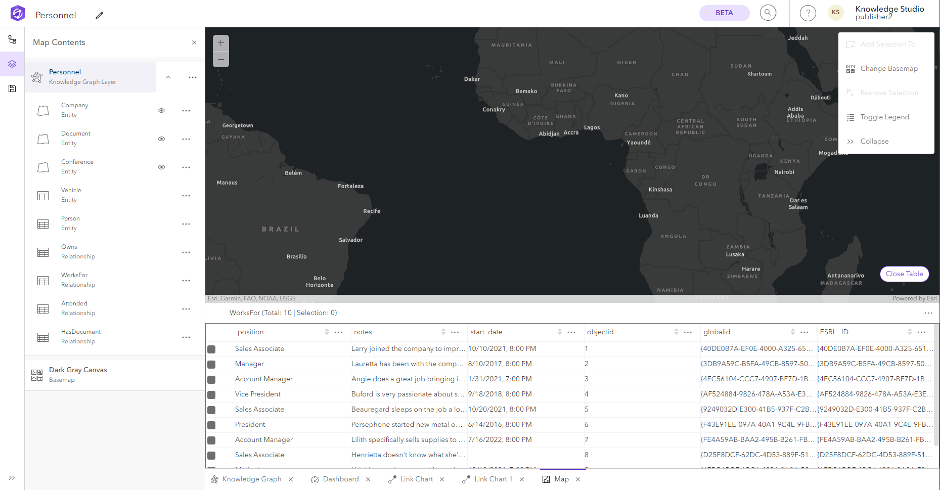

You can display an interactive table at the bottom of a view to see information about features or records in a specific entity type or relationship type sublayer.
  1. Click Options Options next to the sublayer name in the Map Contents pane.
  2. Click Open Table Table in the drop-down menu.
The table appears at the bottom of the view.
Map with table open
