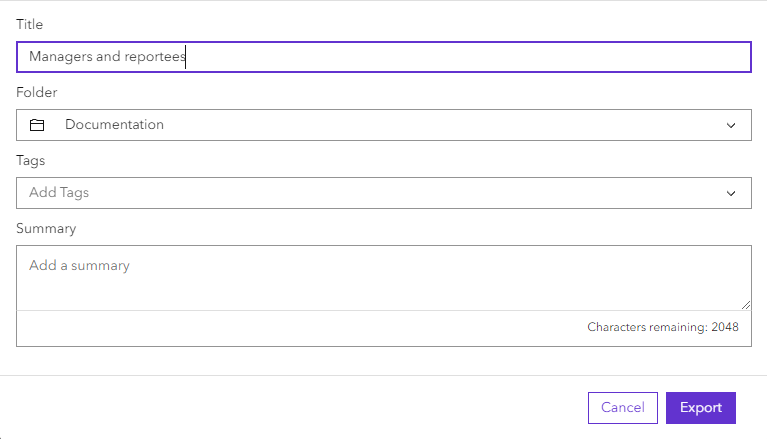

    The Export wizard appears.
    Export content modal
    By default, the item uses the name of the link chart in Knowledge Studio and saves to My Content.
  3. Optionally:
    • Type a title. A title is required to save the link chart.
    • Choose a folder in My Content where you want to save the link chart.
    • Use the drop-down menu to select one or more categories for the link chart if your organization has set up content categories.
    • Type tags that describe the link chart.
      Tags are words or short phrases that describe a link chart. Separate the terms with commas. Federal land is considered one tag, while Federal, land is considered two tags.
    • Type a summary that describes the link chart.
