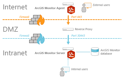

Integrating an existing reverse proxy
If your organization already uses a reverse proxy, you can configure it to route requests to Monitor on your secure internal network.
Diagram of a network with multiple firewalls with a reverse proxy in the DMZ that routes requests to Monitor on the secure internal network

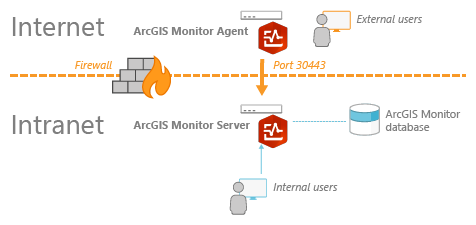

Single firewall
A less secure option uses a single firewall to restrict traffic to Monitor. In this configuration, Monitor resides behind the firewall in the secure internal network and usually, only port 30443 is left open.
Diagram of a network with a single firewall with port 30443 open to allow requests to be sent to Monitor on the secure internal network
For robust network security, place multiple layers of defense between external clients and your internal network. If a single firewall is the only layer of defense, a breach of that layer opens your secure network up to potential malicious activity. For this reason, this type of security configuration is not recommended.
