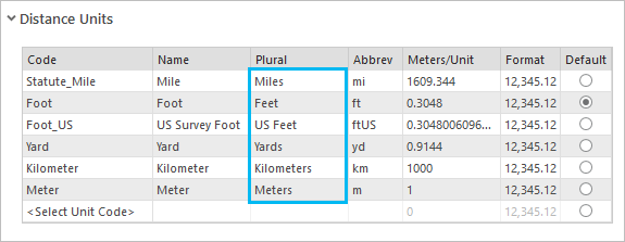

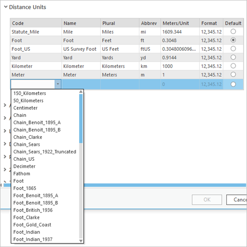

Add a new unit
You can add different units of measurement to the list of available distance, angular, area, location, and direction units.
  1. From the Units page, expand one of the unit types and click <Select Unit Code> at the bottom of the table. Choose from the list of available units.
    Add a new unit.
You can edit some aspects of the unit display directly on the Options dialog box by clicking a cell in the Name, Plural, or Abbrev columns. The default unit can also be set by clicking the buttons under the Default column.

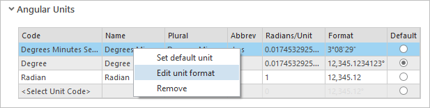

Format a unit
In addition to editing the display names and abbreviations for distance, angular, area, location, and direction units on the Options dialog box, you can also customize the numeric display by opening the Numeric Format or Direction Formatting dialog box.
  1. From the Units page, expand one of the unit types.
  2. For additional formatting options, right-click an existing unit and click Edit unit format.
    Format a unit.
    Depending on the units, the Numeric Format or Direction Formatting dialog box appears. On the dialog box, you can modify a variety of formatting settings, such as the number of decimal places and significant digits that are displayed for the unit you've selected.

Distance units
Distance units are the units in which you can specify or report distances between locations. These units include feet, meters, kilometers, and miles. They commonly appear in editing tools, where you can specify values for length on constraint dialog boxes that use the default unit of measurement. The list of distance units on the Options dialog box is also available in the Measure Distance tool and network analysis tools. For more information, see Distance units for editing.
This is a list of distance units.

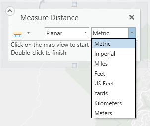

Distance units are available in the Measure Distance tool.
Note:
The Metric and Imperial unit options in the Measure Distance tool automatically change between smaller units of measurement (feet and meters) and larger units of measurement (miles and kilometers), depending on the length of the measurement.

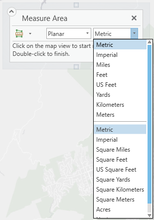

Area units
Area units are used to describe the size of two-dimensional planes. These units are available in the Measure Area tool .
The Measure Area tool uses area units.

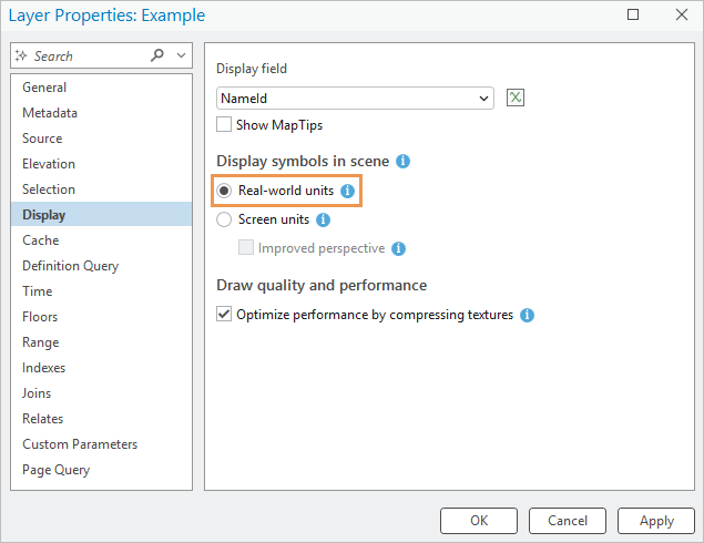

3D symbol display units
These units are used to render dimensions of shapes, distance tolerances, and offsets for three-dimensional symbols. The unit chosen here applies to a symbol's length, width, and height. The default unit is meters. Units added to the list of distance units automatically appear in the list of 3D symbol display units. For more information, see Symbol units and size.
3D symbol display units are used for displaying symbols in real-world units.
