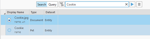

In the example below, a keyword search using the word cookie found two entities in the knowledge graph. One entity has the entity type Pet, and the other is a Document entity. Two properties of the Document entity had text that satisfied the search: the name property and the url property.
Keyword search for cookie with two entities found

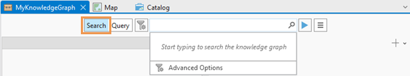

  2. At the top of the investigation view, click in the search text box or press Ctrl+F and click Search, if needed.
    The search control appears.
    Click in the search text box to open the search control.

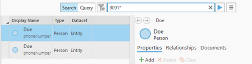

    Searching with the text 9091* returned two entities.

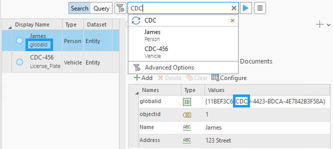

  • Search terms will also match to a partial GUID. For example, a search term can return graph items that match a partial globalid property.
    Graph items returned with properties that match the search term, including a partial global id.

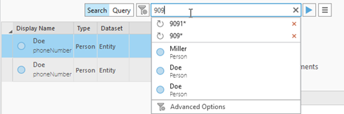

    The search control appears and lists other similar searches in your search history that you can run again. The control will also list the first three graph items returned by the current search for reference.
  2. Update the text of the existing search criteria, for example, by typing new or removing existing characters or adding another keyword. Press Enter to run the search.
    The search control lists recent searches associated with the current search text and the first three entities returned.

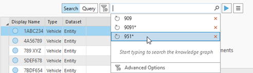

  4. When the search text box is empty, click in the search text box to open the search control and list the three most recent searches that were performed.
    1. Click a search in the list to run it again.
      The search control lists the three most recent searches that were performed.
      The selected search is run and the results of the search appear in the investigation.

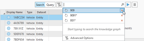

    2. Click the Remove From History button to remove a search from the search history.
      Click in an empty search text box and hover over the Remove From History button.
      The specified search is removed from the list. Your search history is updated to show the three most recent searches.

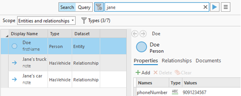

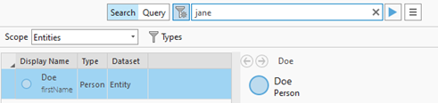

  3. Click the Scope drop-down list and click one of the available options to search different information in the knowledge graph with the provided criteria. For example, click Entities and relationships.
    Entities
    Compare the search criteria to properties of all entity types in the knowledge graph.
    Relationships
    Compare the search criteria to properties of all relationship types in the knowledge graph.
    Compare the search criteria to properties of all entity types and all relationship types in the knowledge graph.

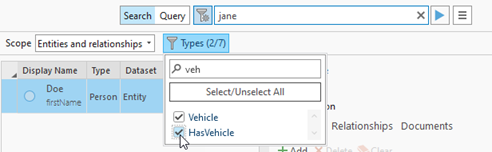

  4. To narrow the searches to specific entity types or relationship types, click the Type Filters button and check all entity types and relationship types to search.
    You can start typing the name of an entity type or a relationship type that you want to select. The list of types is filtered automatically, and you can check the types you want to search in the filtered list. If the scope of the search is entity types, only entity types are listed. If the scope of the search is relationship types, only relationship types are listed.
    This option is not available if you select Provenance in the Scope drop-down list.
    The total number of selected entity types and relationship types appears on the Advanced Options toolbar.
    The Advanced Options toolbar indicates how many entity and relationship types are selected.
