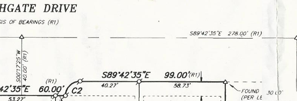

If there is a basis of bearing line stated on your record document, and you can digitize the same line on the map, you can interactively derive the ground to grid correction. A record document states a basis of bearing when all the bearings on the record document are based on the bearing of a designated line. For example, the basis of bearing may be the line between two physical monuments. In the record document below, the dimensions of the road centerline between two monuments is a basis of bearing line. The dimensions of the line are S89°42'35"E and 278 feet.
In the parcel fabric, if the monuments exist as point features, a line can be digitized between the monuments to derive the ground to grid correction.

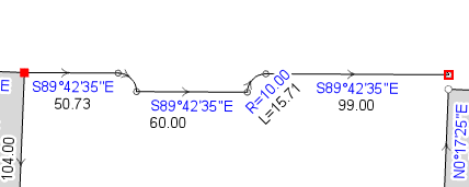

In the example below, a line is traversed between two existing points in the parcel fabric without a ground to grid correction applied. The traversed line does not close or end on the expected endpoint because a ground to grid correction has not been applied.
The ground to grid correction can now be interactively derived by digitizing both the entered line and the expected grid line.
