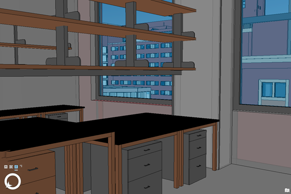

Interior space of a building scene layer.
The interior space of a building scene layer is shown. Copyright 2020: The Ohio State University Facilities Information and Technology Services.
