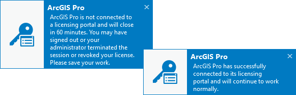

Toast notifications about licensing status
In the first image, a toast notification appears if you sign out of the portal that validates your software license. In the second image, another toast notification confirms that the licensing connection is reestablished.
