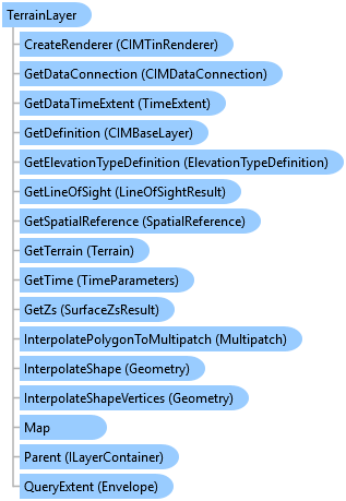

    Object Model
    TerrainLayer ClassCIMTinRenderer ClassCIMDataConnection ClassTimeExtent ClassCIMBaseLayer ClassElevationTypeDefinition ClassLineOfSightResult ClassSpatialReference ClassTerrain ClassTimeParameters ClassSurfaceZsResult ClassMultipatch ClassGeometry ClassGeometry ClassMap ClassILayerContainer InterfaceEnvelope Class
