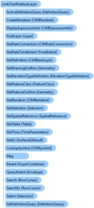

    Object Model
    LinkChartFeatureLayer ClassDefinitionQuery ClassCIMRenderer ClassCIMExpressionInfo ClassLayer ClassCIMDataConnection ClassTimeExtent ClassCIMBaseLayer ClassGeometry ClassElevationTypeDefinition ClassFeatureClass ClassGeometry ClassCIMRenderer ClassSelection ClassSpatialReference ClassTable ClassTimeParameters ClassSurfaceZsResult ClassCIMSymbol ClassMap ClassILayerContainer InterfaceEnvelope ClassRowCursor ClassRowCursor ClassSelection ClassDefinitionQuery Class
