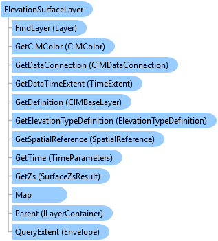

    Object Model
    ElevationSurfaceLayer ClassLayer ClassCIMColor ClassCIMDataConnection ClassTimeExtent ClassCIMBaseLayer ClassElevationTypeDefinition ClassSpatialReference ClassTimeParameters ClassSurfaceZsResult ClassMap ClassILayerContainer InterfaceEnvelope Class
