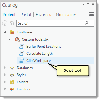

  • Within ArcGIS means you create a script tool inside a toolbox. A script tool is like any other tool—it can be opened and run from the tool dialog box, used in models and the Python window, and called from other scripts and script tools.
Script tool in Catalog pane
