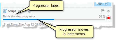

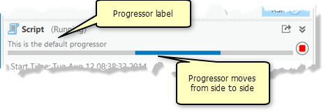

Since script tools share the application, you have control of the progressor. You can control the progressor by choosing either the default progressor or the step progressor, as illustrated below.
Default progressor
Default progressor
Step progressor
Step progressor
