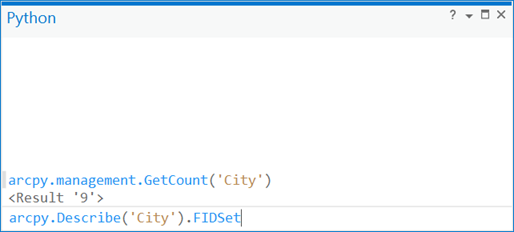

When initially opened, the Python window includes prompt and transcript sections. The prompt is at the bottom of the window, where code is written and entered. The transcript is above the prompt and provides a record of previously entered Python code. It is initially blank.
Python window prompt and transcript
When you press Enter after entering Python code at the Python prompt, the code runs and is moved to the transcript section. Any printed messages or errors will also appear in the transcript section. The Python prompt enlarges to fit the code entered and resizes to its default size after code is executed.

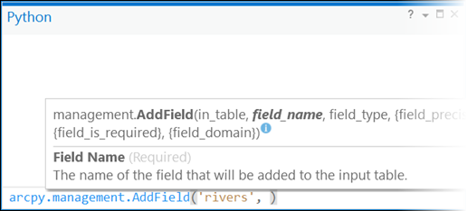

Access help
In Python, tools, functions, and classes all store helpful information. When using a geoprocessing tool, help information can be accessed by positioning the pointer within the round brackets following the name; the window will provide the syntax and the help for the current parameter. In addition, you can access the help topic for any geoprocessing tool by clicking the help button .
Access help in the Python window
