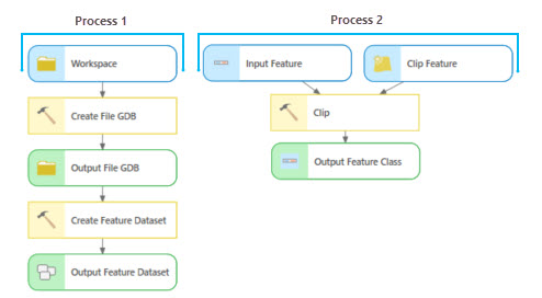

Two disconnected processes
If the model above is run as is, there is no way to control the order of operations. The Clip tool may run before its output location is even created, resulting in an error.

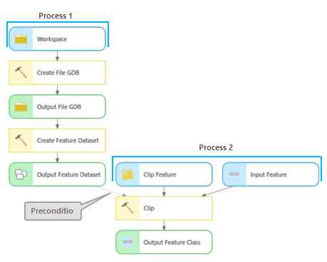

In the model below, the Output Feature Dataset variable must be made a precondition to the Clip tool. By doing this, the Clip tool will run after Create Feature Dataset and the Output Feature Dataset has been created.
Processes with preconditions
