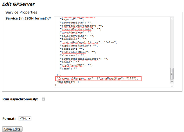

  2. Examine the existing frameworkProperties, typically near the bottom among all the service properties.
    An example of service properties in JSON format
  3. If javaHeapSize is not listed in the frameworkProperties, add {"javaHeapSize":"128"} example. If javaHeapSize is included, increase the value to the appropriate amount.
  4. Click Save Edits to save and finish editing.
