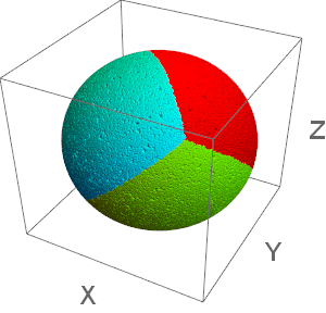

Four Sectors (Tetrahedron)
The Four Sectors (Tetrahedron) sector type divides 3D space into four equal regions, and neighbors are found independently in each of the sectors.
A sphere divided into four equal regions
A sphere is divided into four equal regions (sectors).

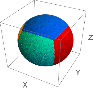

Six Sectors (Cube)
The Six Sectors (Cube) sector type divides 3D space into six equal regions, and neighbors are found independently in each of the sectors.
A sphere divided into six equal regions
A sphere is divided into six equal regions (sectors).

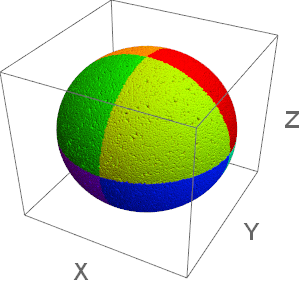

Twelve Sectors (Dodecahedron)
The Twelve Sectors (Dodecahedron) sector type divides 3D space into 12 equal regions, and neighbors are found independently in each of the sectors.
A sphere divided into 12 equal regions
A sphere is divided into 12 equal regions (sectors).
