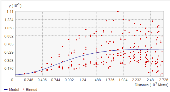

Fitting is done by defining a model that provides the best fit through the points. That is, you need to find a line such that the weighted squared difference between each point and the line is as small as possible. This is referred to as the weighted least-squares fit. This model quantifies the spatial autocorrelation in your data. The image below shows the empirical semivariances (red dots) and the model that best represents the points (blue line):
Geostatistical Analyst variogram

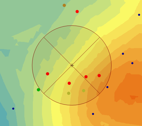

From the kriging weights for the measured values, the software calculates a prediction for the location with the unknown value.
Geostatistical Analyst prediction surface
