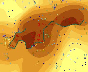

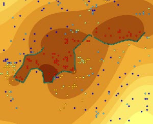

The result of the Diffusion Interpolation With Barriers tool without cost surface, below left, can be compared with a prediction map created using the Kernel Interpolation With Barriers tool, right.
Diffusion interpolation without cost surface Kernel interpolation
In the case of diffusion interpolation, the shape of the kernel is changing near the barrier according to the diffusion equation, while in the case of the kernel interpolation, the distances between points are changing according to the shortest distance between the points.
