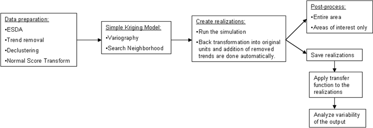

A general workflow for Gaussian geostatistical simulation involves preparing the data, creating the realizations, back transforming the results into original units, and postprocessing the results and/or using the results as input to a transfer function (model) to assess variability in the model's output. This process is represented in the following figure:
General workflow for Gaussian Geostatistical Simulation.
General workflow for Gaussian geostatistical simulation

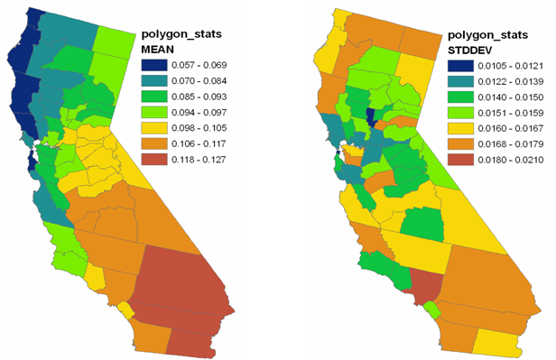

An example of conditional simulation and postprocessing output
The following figure shows the results of conditional simulation with polygon postprocessing of the output. The maps show the mean and standard deviation of 100 realizations of ozone values for each county in California. These mean and standard deviation values could be used, for example, in epidemiological studies where the occurrence of a disease needs to be compared with the average ozone value for each county.
Conditional simulation with polygon output.
