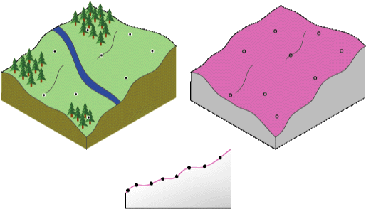

RBFs are conceptually similar to fitting a rubber membrane through the measured sample values while minimizing the total curvature of the surface. The basis function you select determines how the rubber membrane will fit between the values. The following image illustrates conceptually how an RBF surface fits through a series of elevation sample values. Notice in the cross section, the surface passes through the data values.
Radial basis functions
The cross section illustrates how the RBF surface fits through the sample values.

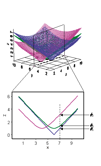

In the ArcGIS Geostatistical Analyst extension, RBFs are formed over each data location. An RBF is a function that changes with distance from a location as shown in the image below.
RBF concept diagram
RBF functions for different locations are shown.
For example, suppose the radial basis function is simply the distance from each location, so it forms an inverted cone over each location. If you take a cross section of the x,z plane for y = 5, you will see a slice of each radial basis function. Now, suppose you want to predict a value at y = 5 and x = 7. The value of each radial basis function at the prediction location can be taken from the figure above, given by the values Φ1, Φ2 , and Φ3, which depend on the distance from each data location. The predictor is formed by taking the weighted average w1Φ1 + w2Φ2 + w3Φ3 + …
Now you need to determine the weights. So far, you have not used the data values at all. The weights w1, w2, w3, and so on, are found by requiring that, when the prediction is moved to a location with a measured value, the data value is predicted exactly. This forms N equations with N unknowns and can be solved uniquely. So, the surface passes through the data values, making predictions exact.
The radial basis function in this example is a special case of the multiquadric RBF. In Geostatistical Analyst, you can also use other RBFs, such as completely regularized splines, thin-plate splines, splines with tension, and inverse multiquadric. Sometimes, the difference between these is not great, but you may have reason to choose one, or you can try several and use cross-validation to select one. Each of the RBFs has a parameter that controls the smoothness of the surface.
