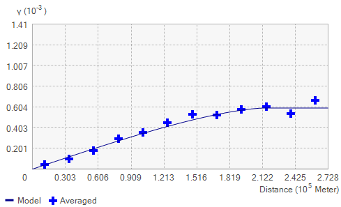

Range and sill
When you look at the model of a semivariogram, at a certain distance, the model levels out. The distance where the model first levels out is known as the range. Sample locations separated by distances closer than the range are spatially autocorrelated, whereas locations farther apart than the range are not.
The value that the semivariogram model attains at the range (the value on the y-axis) is called the sill. The partial sill is the sill minus the nugget.
The following image shows an example of a semivariogram:
Semivariogram
