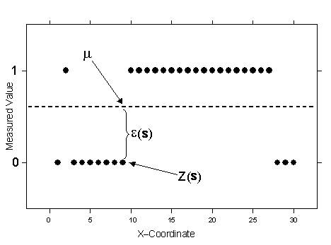

Threshold
The observed binary data is given by the open squares. The unknown mean for all indicator variables is shown by the dashed line, and it is µ. This can be compared to ordinary kriging. As with ordinary kriging, you assume that ε(s) is automatically correlated. Notice that because the indicator variables are 0 or 1, the interpolations will be between 0 and 1, and predictions from indicator kriging can be interpreted as probabilities of the variable being 1 or being in the class that is indicated by 1. If a threshold was used to create the indicator variable, the resulting interpolation map would show the probabilities of exceeding (or being below) the threshold.
