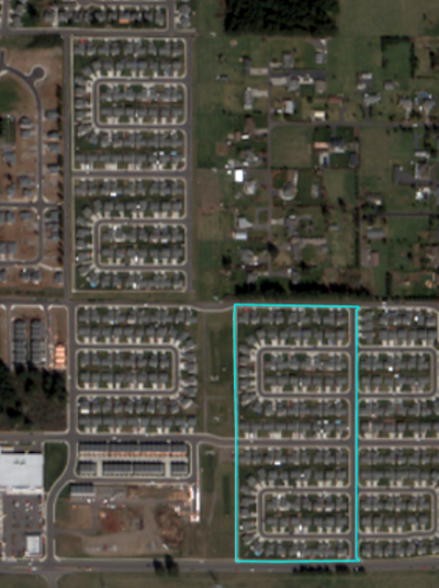

  4. Draw a polygon around an existing housing development. You will copy that region to the vacant lot to the northwest.
    Select a region

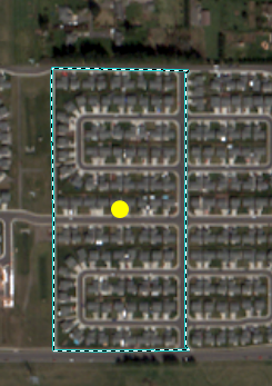

  6. Click the drop-down arrow below Capture, and choose Copy Region .
    If a region is not selected when you choose Copy Region, you can create a polygon region.
    A small yellow circle appears in the center of the copied polygon.
  7. Click and hold the mouse button on the circle, and drag it to the new location on the map.
    Move region
    Drag the yellow circle to move the copied region to the new location.

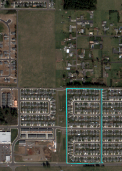

  9. When you're finished, double-click the display to accept the update.
    A copy of the selected region is pasted into the location where the vacant lot used to be.
    Copied region
