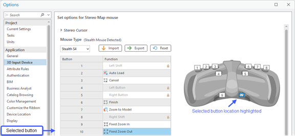

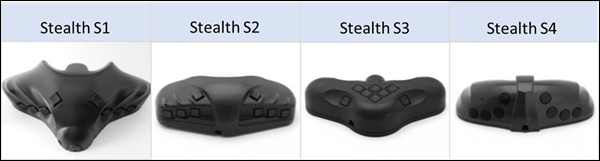

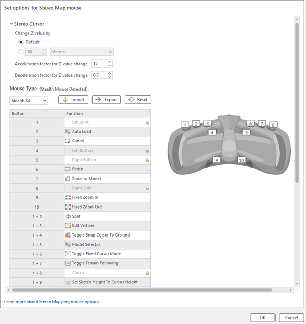

  5. From the Mouse Type drop-down list, select the Stealth mouse model you are working with.
    A graphic of the selected mouse model is displayed on the page. You may need to expand the page to view the full image.
    The button function user interface shows default button assignments and allows you to assign commands to your preferred mouse buttons.

Various editing and stereo mapping functionality can be assigned to the Stealth mouse buttons to enhance stereo mapping efficiencies. The Stealth mouse is equipped with 10 buttons, a thumbwheel and two joysticks (Stealth S4 model only). Excluding the joysticks, these buttons can accommodate up to 32 programmable functions. Functions cannot be assigned to the joysticks. The S3 model can accommodate 20 programmable functions. A list of commands that can be assigned to the mouse buttons is shown in the steps below.

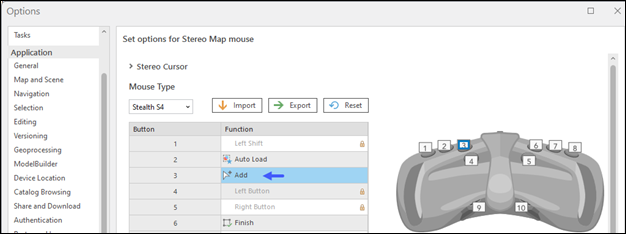

  1. In the Button column, click a specific button or button combination number to assign a function to.
    The function associated with the selected mouse button is highlighted in the list. The selected mouse button is highlighted in blue on the Stealth mouse graphic.
    Assign functions to the stereo mouse.

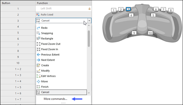

  4. Click the function next to the mouse button number you want to assign the custom command to and expose the drop-down list.
    You may need to click into the row twice.
  5. From the drop-down list, select More commands at the bottom of the list.
    The Commands dialog box appears.

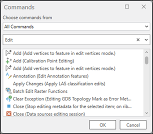

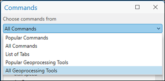

  6. On the Commands dialog box, click the drop-down list below Choose commands from to expose a list of options that can be used to search for new commands to be assigned to mouse buttons. These include All Commands (the default), List of Tabs, Popular Geoprocessing Tools, and All Geoprocessing Tools.
    Stealth mouse command dialog box
  7. With All Commands selected, type a keyword to be used to aid searching for your preferred command in the Search box.
    For example, type Edit, and the search results will list a number of related commands to choose.
    List of commands for the Stealth mouse
  8. Select from the search results your preferred command, and click OK.
    The new command is assigned to the mouse button selected, and appended to the default list of commands.

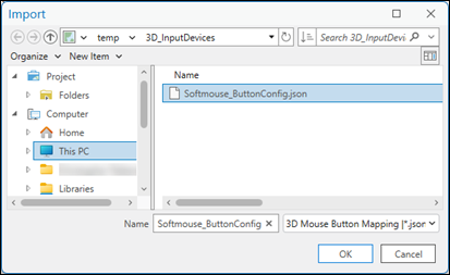

    The Export window appears.
  5. Browse to the folder to save the exported file, enter a file name, and click Save.
    Export the Stealth mouse settings.
    The exported file is saved at the defined location with a .json extension.

    The Import window appears.
  5. Browse to the folder where the configuration file to be imported resides, select it, and click OK.
    Import the custom Stealth mouse settings.
    The imported button settings replace those that were previously listed.

Adjust the mouse z rate of change sensitivity

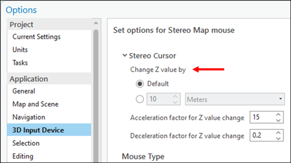

The thumbwheel on the Stealth mouse enables accurate height adjustments in the stereo window. Height increment changes are controlled by the Change Z Value By option in the Stereo Cursor section, found at the top of the Set options for Stereo Map mouse window.
Stereo cursor Z setting
This option can also be found on the ArcGIS Pro main menu, on the Stereo Map tab, with the Z Sensitivity option in the Cursor group. For ease of access, it is recommended that you use the Z Sensitivity option when working in the Stereo map display.
Z Sensitivity setting on the Stereo Map tab
The default settings change the height value in system-defined increments. For smaller, or specific, increment changes, follow the steps below.
