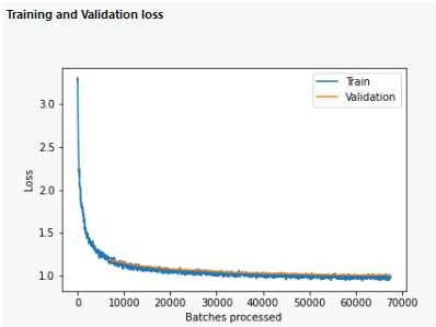

Training and Validation loss
This section displays a graph that shows training loss and validation loss over the course of training the model.
Training and validation loss

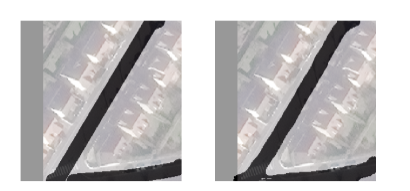

Sample Results
Shows examples of ground reference and predictions pairs.
Examples of ground reference and predictions pairs

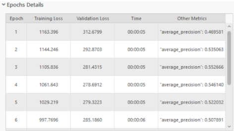

Epochs Details
A table containing information for each epoch, such as training loss, validation loss, time, and other metrics.
Epochs Details table
