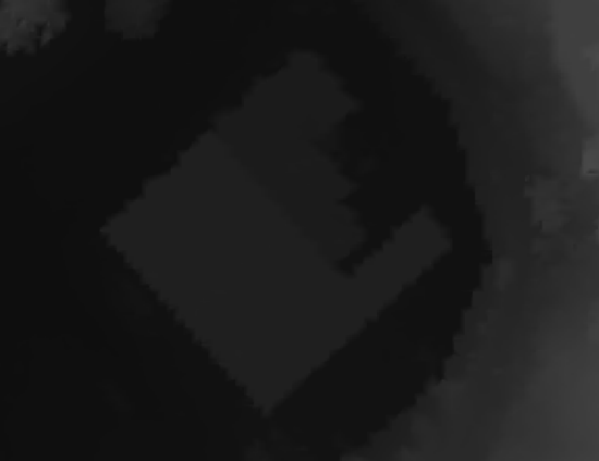

  1. Zoom in to the area where you want to remove a building to derive the terrain model. If detailed elevation is difficult to see, we can view the elevation as a shaded relief.
    Elevation view

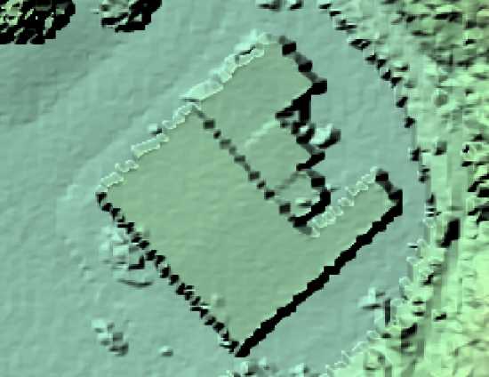

  2. On the Inspect tab, click the Shaded relief button .
    Shaded relief view

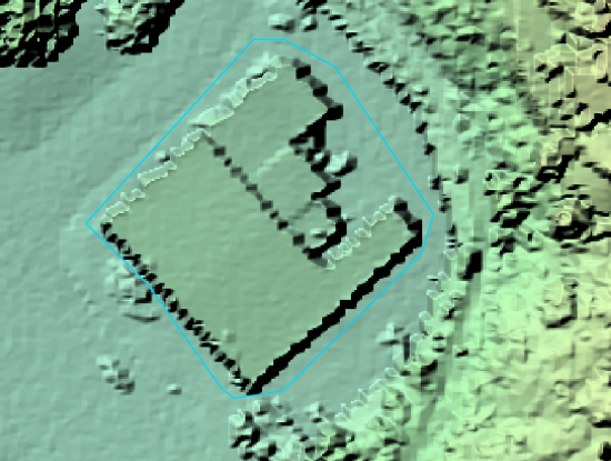

  1. On the Pixel Editor tab, click the drop-down arrow below Region Mode, and choose New .
  2. Click the drop-down arrow below Region, and choose Polygon .
  3. Draw a polygon around the building; double-click to end the polygon.
    New region polygon

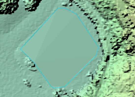

  1. Click the Operations drop-down menu, and choose Interpolate From Vertices from the gallery.
    This will open the Pixel Editor Operations pane.
  2. Make sure that the region you created is selected. If not, click the Select tool from the Region group, and select the region.
  3. Choose the Interpolation Method to use. For this workflow, choose Linear Tinning.
  4. Optionally, you can check the Blend check box, so that your region looks more seamless in the raster. Choose a Blend Width of 2 (pixels).
  5. In the Pixel Editor Operations pane, click Apply. The values from the vertices of the selected region will be used to ground values.
    Result of Fill from Vertices
