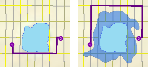

  • A restriction polygon barrier prohibits travel anywhere the polygon intersects the network. One use of this type of barrier is to model floods covering areas of the network and making road travel there impossible.
    Two maps demonstrate how a restriction polygon barrier affects a route analysis.
    The left side depicts the shortest path between two points. On the right, a polygon barrier blocks flooded streets, so the shortest path between the same two points is different.

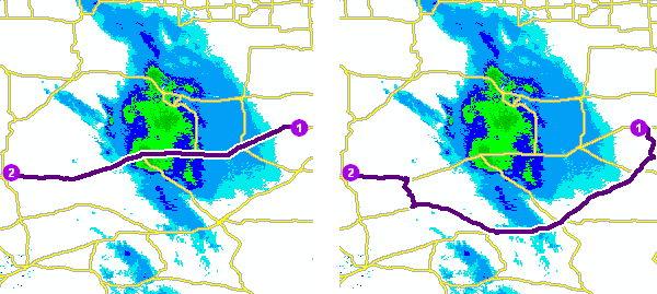

  • A scaled cost polygon barrier doesn't restrict travel on the edges and junctions it covers; rather, it scales the cost of traversing the covered edges and junctions by a factor you specify, such as 0.25, which means travel is expected to be four times faster than normal. A factor of 3.0 means it is expected to take three times longer than normal. This type of barrier can be used to model storms that reduce travel speeds in specific regions.
    Two maps demonstrate how a scaled cost polygon barrier affects a route analysis.
    The map on the left shows a route that goes through inclement weather without regard for the effect poor road conditions have on travel time. On the right, a scaled cost polygon barrier doubles the travel time of the roads covered by the storm. Notice the route still passes through the southern tip of the storm since it is quicker to spend more time driving slowly through a small part of the storm than it is to drive completely around it. As with the scaled cost line barrier, the solver uses the modified cost in calculating the best route; furthermore, the modified cost is included in the accumulated costs of the results.
