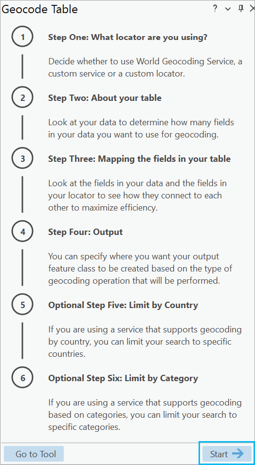

  1. In the Catalog pane, browse to the location of the tutorial data, right-click SanFranciscoLocator.loc, and click Add to Project.
  2. Right-click CoffeeShops.csv, and from the context menu, select Geocode Table.
    The Geocode Table pane appears.
  3. In the Geocode Table pane, click Start.
    Geocode Table pane
  4. From the Input Locator drop-down list, select SanFranciscoLocator.
  5. In the Geocode Table pane, click Next.
  6. Ensure that Input Table is pointing to CoffeeShops.csv; the drop-down list has More than one field as the address for the customers in the StreetAddress, City, and Postal fields;, and click Next.
  7. Map the address fields as follows:
    • Address or Place to StreetAddress
    • City to City
    • ZIP to Postal
    • State to State
  8. Click Next.
    Leave the Output as is to save it to the project workspace.
  9. For Preferred Location Type, choose Routing Location from the drop-down options.
    This option places the located features on the street network location instead of the roof top. In Network Analyst, points are spatially located at the closest street edge. The center of a building can sometimes be closer to a street other than the driveway access street.
  10. Leave Output Fields set to All, and click Next.
  11. For Category, check Address, and click Finish.
  12. Click Run.

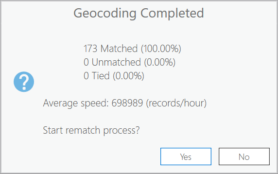

    Once the process finishes, a message appears asking if you want to rematch.
  13. Click No, since all the locations were matched correctly.
    Geocoding Completed message
  14. Close the Geocode Table pane.

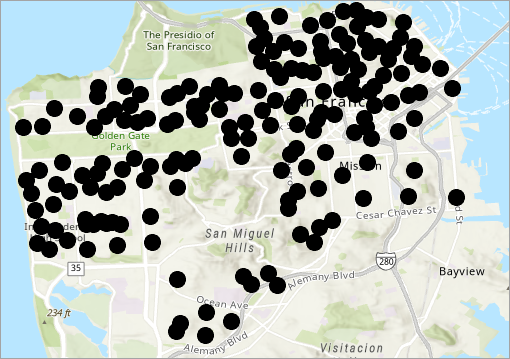

  3. Select CoffeeShops_Geocoded for Input Locations.

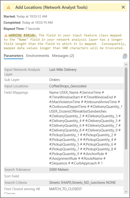

    In steps 4 through 6, you will do a field mapping. This is to ensure that the information regarding the coffee shops from the CoffeeShops_Geocoded feature class is correctly mapped and populated to the matching fields in the Orders sublayer.
  4. Under Field Mappings, select Name from the Property section.
  5. From the Field Name drop-down list, select USER_Name near the bottom of the list.
    The Last Mile Delivery solver requires a unique name for each order. Since every coffee shop on the list for delivery has a unique name, the coffee shop names (in the USER_Name field) is mapped to the Name field on the Orders sublayer.
  6. Map the following additional property as DeliveryQuantity_1 > USER_DozensOfBreakfastSandwiches.
    The sandwich shop is delivering sandwiches by the dozen. The quantity to be delivered to each shop is tracked in the USER_DozensOfBreakfastSandwiches field so this will be mapped to the DeliveryQuantity_1 field allowing the Last Mile Delivery solver to track the dozens of sandwiches delivered to each location.
  7. Select CurbApproach from the Property section, and select Right side of vehicle from the Default Value drop-down list.
    The CurbApproach field designates the side of the street the location must be in relationship to the vehicle when servicing it. With these routes being in San Francisco, where cars drive on the right side of the street, setting CurbApproach to the right side of the vehicle ensures that the delivery van is parked at the curb next to the coffee shops, and the driver will not need to cross the road.
  8. Click OK.
    The coffee shops are added to the Orders sublayer.
    Coffee shops on the Orders sublayer
    A warning message appears indicating that the geocoding process made the Name field in the CoffeeShops_Geocoded feature class too long for the Name field in the Orders sublayer. Close the warning message window since the names were not too long.
    Warning message

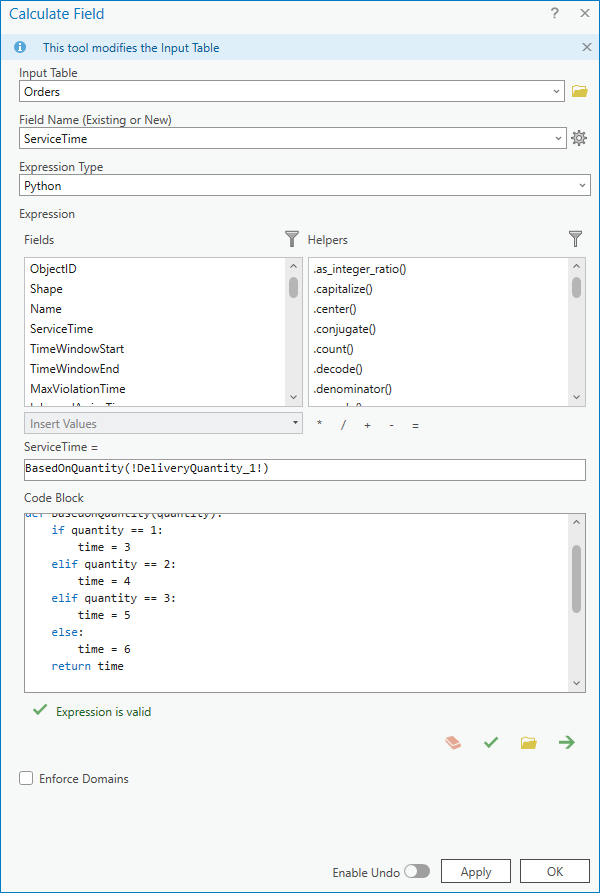

    You will now update the service time based on the delivery quantity.
  9. In the Contents pane, right click the Orders sublayer, and select Attribute Table.
  10. In the attribute table, right-click the ServiceTime field, and select Calculate Field.
    The Calculate Field dialog box appears.
    In steps 11 and 12, you will calculate the service time based on the quantity of sandwiches a particular coffee shop ordered. The quantity ordered is by the dozen and the time it takes to deliver is in minutes. If the coffee shop ordered one, two, or three dozen sandwiches, it will take 3, 4, or 5 minutes, accordingly, to make the delivery. Any order above three dozen will take 6 minutes to deliver to the coffee shop.
  11. Set the ServiceTime value to BasedOnQuantity(!DeliveryQuantity_1!).
  12. Use the following for Code Block:
    def BasedOnQuantity(quantity):
        if quantity == 1:
            time = 3
        elif quantity == 2:
            time = 4
        elif quantity == 3:
            time = 5
        else:
            time = 6
        return time
    The window should resemble the following:
    Calculate Field dialog box with populated parameters
  13. Click the check mark to verify the expression.
  14. Click OK.
    The ServiceTime field is now populated with an appropriate value.

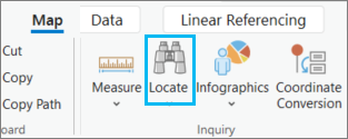

To add the sandwich shop location, complete the following steps:
  1. Click the Map tab, and in the Inquiry group, click the Locate button .
    Locate button in the Inquiry group

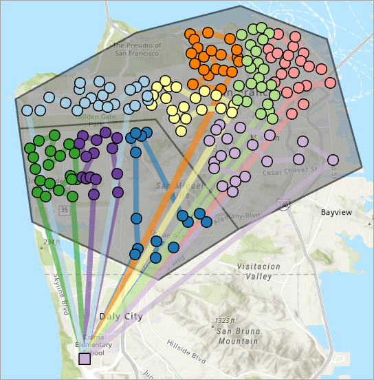

Add information to the Routes sublayer
Routes include information about both the vehicle and the driver. Information can be included about a driver's workday, such as when they start and how long they can work in a day. Vehicle information can also be included, such as capacity and the cost to operate it.
To efficiently deliver the orders to 173 coffee shops, set the following parameters while adding the routes. You will specify the number of routes that can service 173 coffee shops, the starting and ending location of the route (which is the location of the sandwich shop), the earliest time that the route can begin (the delivery time window is 5 a.m. to 7:30 a.m.), the capacity of the truck, the maximum total time the route can travel, and how much a driver is paid per hour.
To add routes and other information to the Routes sublayer, complete the following steps:
  1. In the Contents pane, right-click the Last Mile Delivery group layer name, and select Zoom to Layer to zoom out to the full extent.
  2. Return to the Last Mile Delivery Layer tab.
  3. In the Input Data group, click the Import Routes drop-down list, and select Add Routes.
    The Add Fleet Routing Routes dialog box appears.
  4. Set the following values:
    1. Number of Routes—12
      The sandwich shop has 12 vehicles for these deliveries so that is the number of routes they can send.
    2. Start Depot Name—50 Southdale Ave, Daly City, CA 94015
      The route must start and end at the sandwich shop, so both the Start Depot Name and End Depot Name values are the address of the sandwich shop.
      You can select Start Depot Name from the drop-down list and the value must match the value in the Name field of the Depots sublayer.
    3. End Depot Name—50 Southdale Ave, Daly City, CA 94015
      You can select End Depot Name from the drop-down list and the value must match the value in the Name field of the Depots sublayer.
    4. Earliest Route Start Time—5:00 am
      The routes must start at 5:00 a.m. to get the breakfast sandwiches to the coffee shops in time for the morning rush.
    5. Capacity_1—150
      Each vehicle can hold a maximum of 150 dozen breakfast sandwiches. It is important that the units used for Capacity_1 match the units for DeliveryQuantity_1, which in this case is dozen of sandwiches.
    6. Max Total Time—150
      The routes must be finished and back at the sandwich shop by 7:30 a.m. This gives the drivers 2.5 hours to complete their routes. Since the time field units being used to model this problem is minutes, you need to enter 150 minutes for Max Total Time.
    7. Cost Per Unit Time—0.5
      The drivers are paid $30 per hour, but since minutes are used to model this problem, it equals $0.5 per minute.
  5. Click OK to run the tool.
    Twelve routes are added to the Routes sublayer.

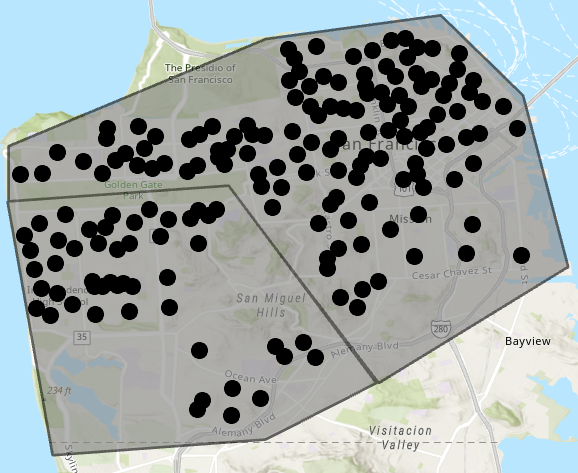

Add zones
To keep drivers in their preferred regions of town, you will now add zones.
  1. On the Last Mile Delivery Layer tab, in the Input Data section, click the Create Features button .
  2. In the Create Features pane, select the Zones template.
  3. Draw two polygons to separate the north and south of Golden Gate Park and San Miguel Hills. The zones should resemble the image below.
    North and south zones added
  4. In the Contents pane, right-click Zones, and select Attribute Table.
  5. For the polygon south of Golden Gate Park and San Miguel Hills, change the Name field value to South.
  6. For the polygon north of Golden Gate Park and San Miguel Hills, change the Name field value to North.

    This places a limit on the remaining nine routes that can deliver orders in the northern zone only.
  13. Clear the selection and save the edits.
  14. Close the attribute table.
Set the date and run the analysis
You will now set a date for when the routes will start. You don't need to set the time because each route has a time set from when you added routes using the Add Fleet Routing Routes tool in a previous section.
  1. On the Last Mile Delivery Layer ribbon, in the Date and Time section, click the Default Date drop-down arrow and set the date as 03/14/2024.
  2. In the Analysis group, click Run.
    The Last Mile Delivery layer solves. The orders are assigned to routes, and the symbology updates to show the routes and their assigned orders in matching colors.
    Orders that are serviced by a specific route are displayed in a matching color code
  3. In the Contents pane, right-click the Routes sublayer, and select Attribute Table.
  4. Scroll to the right on the table to the OrderCount output field.
Review the results. Several feature classes in the Last Mile Delivery analysis layer have output fields that provide details about the solved solution. The Routes table provides an overview of each route, but you can also review details about each order. The Routes output includes the number of locations each driver goes to, the total time it takes, when the route starts, and when it is expected to return to the sandwich shop. You will notice that three routes did not service any of the coffee shops, because they were covered by other routes. Consequently, most of the fields for these three routes have null values.
