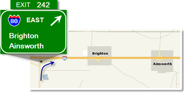

Signposts provide the type of directional information found on highway road signs, such as exit numbers, connecting roads, and major destinations that can be reached along the connecting roads. If you have signpost data, you can use it to enhance the route directions generated by ArcGIS Network Analyst extension. For example, the road sign in the image below informs northbound drivers that if they take exit 242, they will enter the eastbound side of Interstate 80, which connects to Brighton and Ainsworth.
Example of a signpost

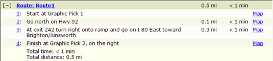

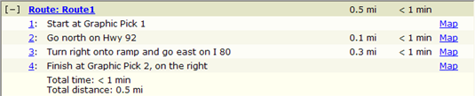

A short route along the arrow in the image above was created, and the directions, with and without signposts, are compared below. The third step in each case highlights the difference:
Directions without signposts
Directions with signposts
A driver who uses the second set of directions can avoid making a wrong turn by matching more of the information on the directions to the sign that is encountered on the road.

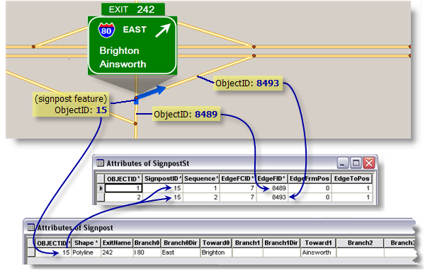

The following image and attribute tables illustrate how the green sign can be modeled:
Features and corresponding ObjectIDs used to model the signpost
Note that the language fields were removed from the Signpost attribute table in this image.
  • The signpost feature (symbolized as the thick blue arrow) gives directions for a turn across two street features; therefore, two records represent the signpost in the signpost streets table.
  • Since the ObjectID of the signpost feature is 15, the SignpostID for both records in the table is 15.
  • The EdgeFCID refers to a system-generated feature class identifier that is automatically assigned to a feature class when it is created. The streets feature class in this example was assigned 7.
  • The EdgeFID refers to the ObjectID of a unique street feature in the streets feature class.
  • Since the signpost feature begins on street 8489, the Sequence value for that record is 1.
  • Since the signpost feature ends on street 8493, the Sequence value is 2 (optionally, the last edge could be assigned a value of 0 instead).
  • Since street 8489 was digitized from south to north—the same direction as the signpost—the EdgeFrmPos and EdgeToPosition values are 0 and 1, respectively. The same is true for street 8493. However, if the digitized direction of the street went against the signpost direction, the 0 and 1 values would be switched.
