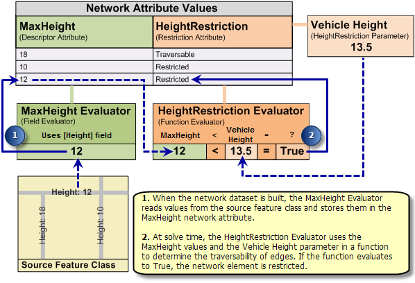

In such a scenario, you might create two attributes: a descriptor attribute and a restriction attribute, naming them MaxHeight and HeightRestriction, respectively. MaxHeight uses clearance values from the source data, and HeightRestriction reads the values from MaxHeight and compares them with a parameter containing the current vehicle height. The following diagram shows a generalized version of this process:
Finding values for a parameterized restriction attribute

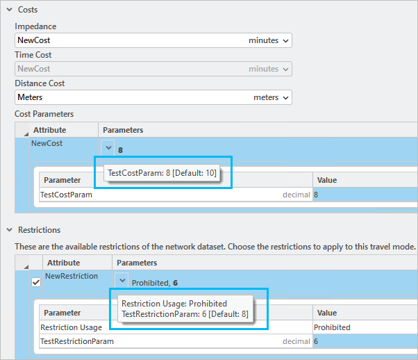

Note:
If you change the value of the cost or restriction attribute parameter on the Travel Modes tab, the new value appears in bold, and if you hover over the bold text, a pop-up appears indicating the current and default value of the parameter. This also indicates that the edited value is only used for the current travel mode and the default value of the parameter remains unchanged.
Edited parameter values for cost and restriction attributes
