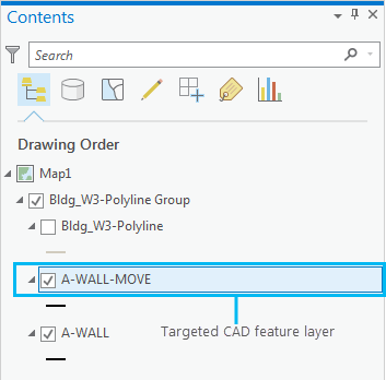

Choose a georeferencing CAD feature layer
All commands and tools on the Georeference tab act on the CAD feature layer selected in the Contents pane. Georeferencing a single CAD feature layer applies that transformation to the entire CAD dataset. Once you have georeferenced a CAD feature layer, you can add the other feature classes of that CAD dataset to the map and they will be positioned by the same control points.
Note:
The CAD Data tab is not visible when a CAD group layer is selected. To display the tab, select a child feature layer in the CAD group layer.
