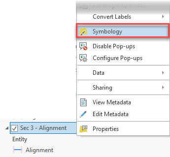

  1. From the Contents pane, browse to the Alignment feature layer and click Alignment to access to the symbology definition.
    • Another way to do so is to right-click the Alignment feature layer and select Symbology.

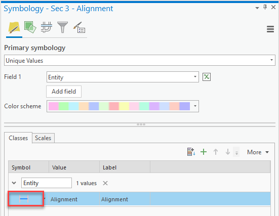

  2. Once in the symbology definition, click the Alignment symbol.

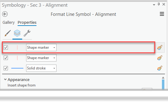

  3. On the Properties tab, select the first definition.

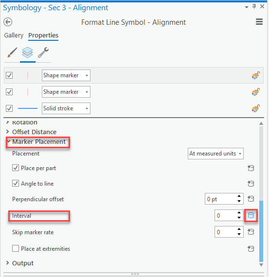

  4. Scroll down, expand the Marker Placement group, and click the drum in the Interval option.
    This will open a code editor from where you need to change a value.

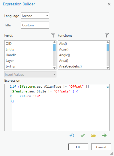

  5. Select the X to open the editor.
    Arcade code initially checks whether the Type of the alignment is different than Offset and the Style is different than Offsets. These values are read from attributes in the feature class. If the alignment doesn’t have any of those values, apply a number for the interval, in this case, 10, and that is the value that you need to change.
    Note:
    In Autodesk Civil 3D, the default symbology for the alignments renders those with the Offset type without the station, and that is what you are doing here. If the alignment is Offset, it takes the default value of 0, which means no stations will be rendered.
  6. Replace the value 10 with 15 and click OK to save the changes.

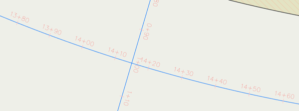

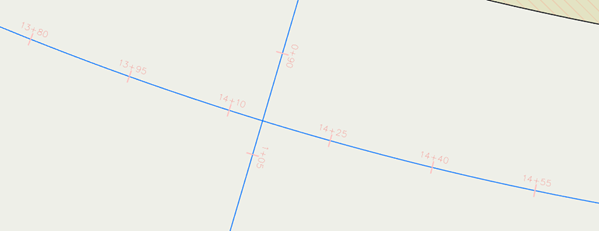

    The symbology is refreshed in the map, and you can see that the stations now are rendered every 15 meters.

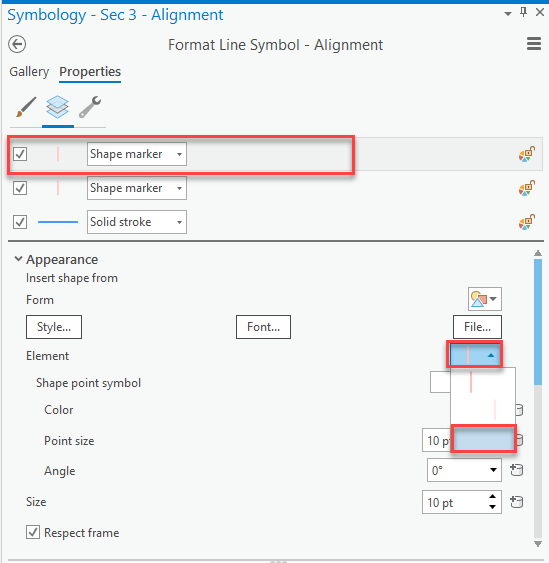

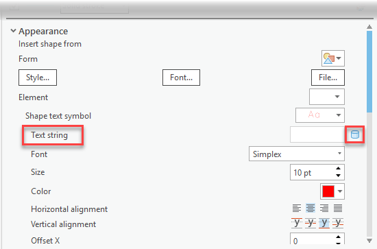

  9. From the station definition (that was accessed in the previous section), expand the Appearance group and open the drop-down list for Element. Then select the last row, which is empty. This will give you access to the text definition.
  10. Click the drum for Text string.

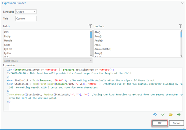

  11. Select the X to open the editor.
  12. Expand and review the code.
    There are functions used to build the mask for the $measure value. The generated mask looks like this: ###00+00.##
    You’ll change the mask to make it look like this: ###0+000.##.
    In line 4, add a 0 to the mask definition ## so it would look like 000.##.
    In line 5, replace 100 with 1000. Then change the mask, removing a 0, so from ###00 so it would look like ###0.
    Click OK to save the changes and close the editor.

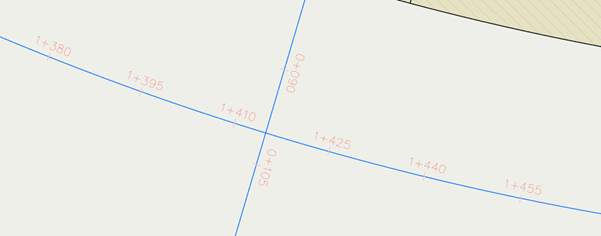

    The symbology is refreshed in the map, and you can see that the stations now are rendered with the new mask

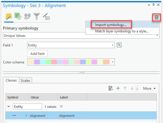

  18. Go to the symbology definition of the feature layer where you want to apply the symbology and select Import symbology.
    The Apply Symbology From Layer geoprocessing tool opens.
  19. In the Symbology layer, select the LYRX file that you saved in a previous step, and click Run.
