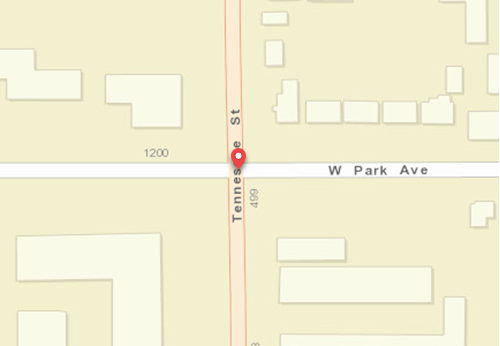

Physically connected intersections
A typical intersection is formed when two street segments physically cross each other. An example of this is W Park Ave and Tennessee St, Redlands, CA.

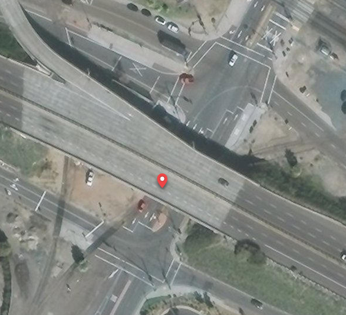

Intersections not physically connected
You can find intersections between streets that are not physically connected. This includes cases where streets are separated by elevation, such as a highway overpass crossing over another street. An example of this type of intersection is Pacific Hwy and W Washington St, San Diego, CA 92140.
Highway overpass intersection

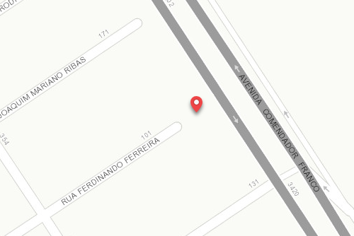

Virtual intersections
A virtual intersection can consist of one point where both streets have the smallest distance between one another, such as a dead end or cul-de-sac, or parallel streets that have multiple points with minimum distances between the disconnected streets. The distance tolerance for a virtual intersection is 60 meters. A virtual intersection is not returned when at least one physically connected intersection is returned. If no physically connected intersection is returned and the streets are separated by a distance within the tolerance, a virtual intersection result is returned. An example of a virtual intersection search is Rua Ferdinando Ferreira @ Avenida Comendador Franco, Curitiba, BRA.

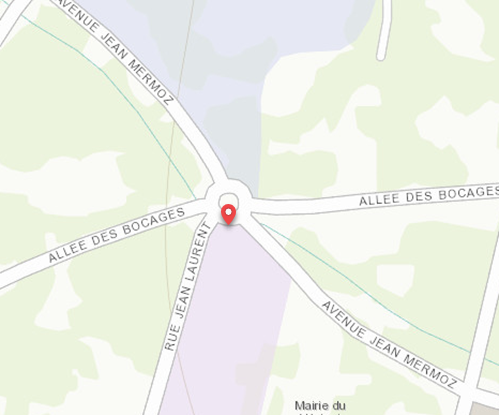

Roundabouts
Another type of disconnected intersection that is supported is a roundabout. A roundabout is formed when two or more streets connect to a circular roadway, which is often unnamed. The participating streets typically don't connect directly to each other, but when you search for them and they are within the distance tolerance, an intersection match is returned by the locator. An example of a roundabout intersection search is Rue Jean Laurent & Avenue Jean Mermoz, Le Vésinet, FRA.
Roundabout

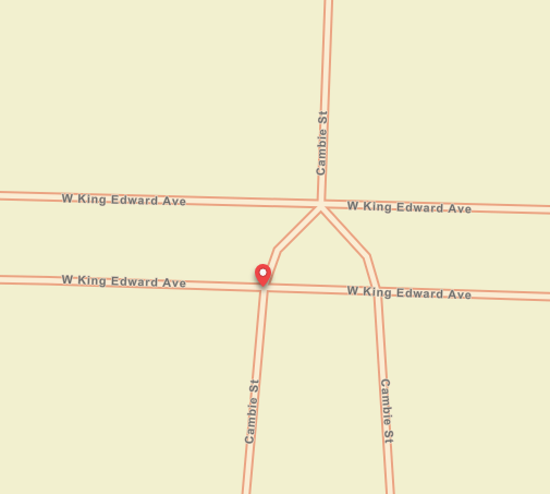

Ambiguous intersections
Sometimes there are multiple possible matches for an intersection search. This typically occurs when divided roads cross each other. A divided road consists of two street segments separated by a median. In this scenario, there can be up to four equivalent intersection matches consisting of the same street names at different locations. The locator uses an ambiguous intersection tolerance with such searches to remove redundant intersection candidates from the results. The default ambiguous intersection tolerance is 30 meters. Specifically, if there are multiple intersection candidates with the same street names that are located in the same locality (neighborhood, city, postal code), and if they are within 30 meters of each other, the locator returns only one of the candidates. An example of an ambiguous intersection search is Cambie St and W King Edward Ave, Vancouver, British Columbia. In this case, there are three potential intersection candidates with the same street names. Because the locations are within the ambiguous intersection tolerance, only one intersection candidate is returned.
