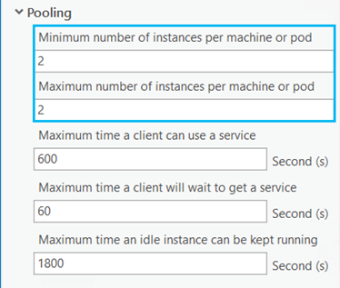

Pooling
Expand the Pooling section and specify the minimum and maximum number of instances of the portal locator that can run per server machine (or per pod if you are connected to ArcGIS Enterprise on Kubernetes) at any one time. Because of the way the server shares these instances among clients, it is possible that the number of clients the server can support is greater than the number of running instances. You must increase the number of instances if the service experiences high traffic or if you plan to parallelize your batch geocoding jobs.
Pooling parameter showing the number of instances
Note:
To ensure that maximum resources are always available for geocoding, set Minimum number of instances per machine or pod and Maximum number of instances per machine or pod to the same value.
The Pooling properties allow you to specify how the portal locator will accommodate users.
