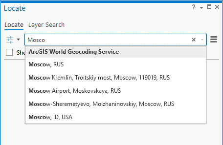

Rank is used to sort geocode results or suggestions for ambiguous queries, such as Lincoln, in which no additional information (state) is available. Depending on the locator, rank indicates the importance of a result relative to other results with the same name. For example, there are cities in Russia and Idaho named Moscow. Moscow, Russia, has a greater population than Moscow, Idaho, so it has a higher rank. Rank values can be based on population or category and the order of the list comes from a combination of rank and location.
Moscow suggestions sorted using rank by population size

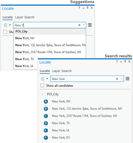

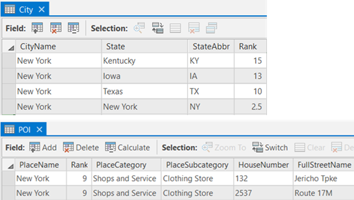

Example: Sort in a multirole locator
Sorting by rank also works for multirole locators. Rank prioritizes the candidates if the search returns multiple candidates from different roles with the same score.
City and POI data with rank values for a multirole locator
According to the rank values, one candidate from the City role is placed higher than candidates from the POI role in suggestion and geocoding results:
Multirole City and POI locator suggestion and search results using rank values
