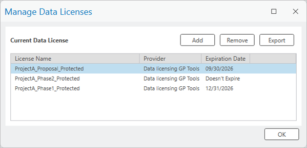

In ArcGIS Pro, the Manage Data Licenses dialog box in the Licensing section on the Project tab provides tools that allow you to register and manage file geodatabase data licenses. Click the Manage your data licensing button to open the Manage Data Licenses dialog box. The dialog box presents a list of licenses with associated information and tools that allow you to manage file geodatabase data licenses.
License list
The list that displays on the Manage Data Licenses dialog box includes information about the file geodatabase licenses you added to this installation of ArcGIS Pro.
  • License Name—This is the name of the licensed file geodatabase that contains data you will access from ArcGIS Pro.
  • Provider—This value reflects how the license was created. This value cannot be altered. If the value is unknown, N/A is displayed.
  • Expiration Date—The date that the data license expires. Access expires at midnight. You can no longer access the data in the licensed file geodatabase the day after this expiration date. If the person who created the license did not set an expiration date, the words Doesn't Expire are displayed.

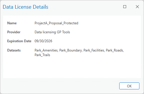

Double-click a file geodatabase in the list to see what data in the file geodatabase is licensed. A pop-up appears that includes additional information, including the names of the datasets in the geodatabase that are restricted by a license. This is useful because the license may not apply to all the datasets in the licensed file geodatabase. You can add data to a licensed file geodatabase, but the license does not apply to any dataset added after the license is generated.
