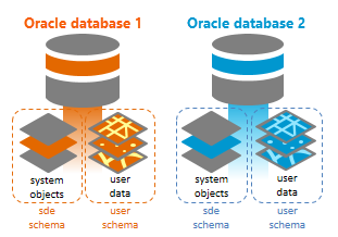

In both cases, each geodatabase is maintained and upgraded independently. Each database can also be deleted independently. In each database, the geodatabase system tables are stored in the sde user's schema and user data is stored in the schemas of individual users.
Two geodatabases, each in their own Oracle database
