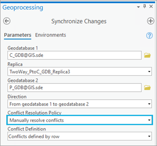

When using the Synchronize Changes tool, there are multiple ways to resolve conflicts. If you're using the Manually resolve conflicts option for the Conflict Resolution Policy parameter on a two-way or one-way replica, the replica may synchronize successfully; however, if conflicts exist, they must be resolved before changes can be exported from this replica.
Manually resolve conflicts option for Conflict Resolution Policy in the Synchronize Changes tool.

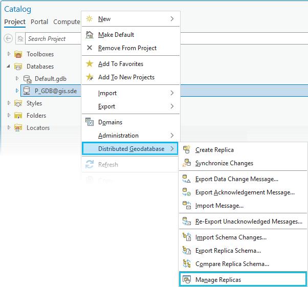

  1. Right-click the geodatabase connection for the replica in conflict, and click Distributed Geodatabase.
    Manage Replicas on the Distributed Geodatabase context menu

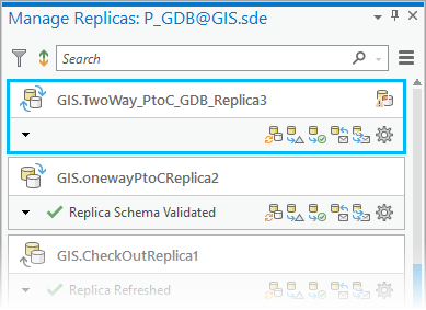

  2. Select Manage Replicas to open a pane that displays each replica in the geodatabase as a card.
    If the replica is in conflict, the Replica Conflict icon is on the card.
    Manage Replicas pane

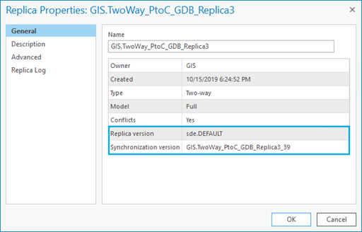

  3. Click the Replica Options button , select Properties, and on the Replica Properties dialog box, click the General tab, and note the names of the following versions:
    • Replica version—This is the version to be replicated.
    • Synchronization version—This is the relative replica version to receive changes.
  4. Close the Replica Properties dialog box.
Note the name of the synchronization version so that you can change to this version and synchronize changes in the next set of steps.
