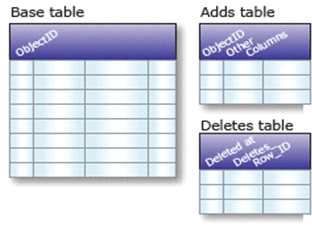

Queries on transactional versions are still on the base and delta tables:

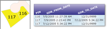

Feature updates
When a feature is updated, the gdb_to_date attribute is set with the time stamp of the archive operation, and a row is inserted to show the current representation of the feature. The gdb_from_date attribute in this new row is set with the time of the archive operation, while the gdb_to_date attribute shows 12/31/9999, since it has yet to be modified or deleted.
The following diagram shows two parcels, 116 and 117, with their corresponding gdb_from_date and gdb_to_date attributes prior to performing the update operation.
If the parcel boundary for parcel 117 is extended, the gdb_to_date attribute is updated with the time stamp of the archive operation, and a new row is created. The gdb_from_date attribute in this new row is set with the time and date of the archive operation.
For example, queries that investigate moments prior to the update (7/12/2005 5:34:22 PM) show parcel 117 as it existed prior to the update. Querying moments before 7/9/2005 2:23:43 PM will not show parcel 117 because it had not been created. Any moment queries after the update (7/12/2005 5:34:22 AM) will show parcel 117 in its current representation with the extended boundary.
