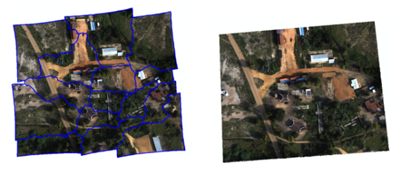

An orthomosaic is a photogrammetrically orthorectified image product mosaicked from an image collection, where the geometric distortion has been corrected and the imagery has been color balanced to produce a seamless mosaic dataset.
Color-balanced imagery showing seamlines and the resulting orthomosaic
