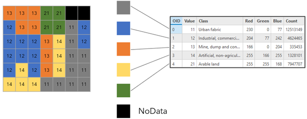

The image below illustrates a raster dataset with an attribute table. The NoData values are not calculated in the raster attribute table. The three columns that are calculated by default are shown; the other columns can be added individually or by using a join operation.
Raster attribute table graphic showing colormap
When a raster attribute table is generated, three default fields are created in the table: OID, VALUE, and COUNT. The content in these fields cannot be edited. The ObjectID (OID) is a unique, system-defined object identifier number for each row in the table. VALUE is a list of each unique cell value in the raster datasets (in a grid, this is an integer). COUNT represents the number of cells in the raster dataset with the cell value in the VALUE column. Cell values represented by NoData are not calculated in the raster attribute table.

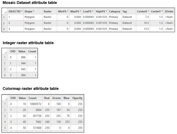

Raster attribute tables in a mosaic dataset
Each raster dataset in a mosaic dataset can have its own attribute table. The method of storage allows you to view the input images and see information about each of the datasets. The associated information provides information about the pixels, or in a mosaic dataset the metadata about the input images.
Raster attribute table examples for a mosaic dataset
