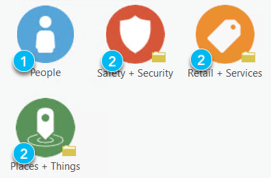

The Explore view can be used to validate the organization of your Indoors categories and category groups, as well as create and manage categories and groups associated with the active map. It shows a view of the categories and groups as they will appear in Indoors Viewer and Indoors mobile apps.
Category and groups in the Explore view
Label
Description
Stand-alone category
Category group
