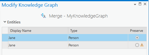

    The Modify Knowledge Graph pane appears. All selected entities are listed under the Entities heading. All relationships in which the selected entities participate are listed under the Relationships heading. When you click an entity or relationship under these headings, the properties of the selected graph item are displayed under the Properties heading.
  3. Under the Entities heading, click in the Preserve column to choose the entity you want to keep.
    All other listed entities will be merged into the entity you chose to preserve.
    To decide which entity to preserve, compare the relationships and properties associated with each selected entity using the tables under the Relationships and Properties headings below.
    Choose which entity you want to preserve.
  4. Click the entity that will be preserved. Under the Properties heading, choose the property values that will be preserved with the entity.
    Suppose two entities describe the same person. The entity to preserve has a birth date of 1982-04-11 and a height of 173 cm. A selected entity that will be deleted has a birth date of 1982-11-04 and a phone number of 909-793-2853. Values of the preserved entity are listed by default, but you can choose to keep a value from one of the other selected entities instead or type in the value you want.

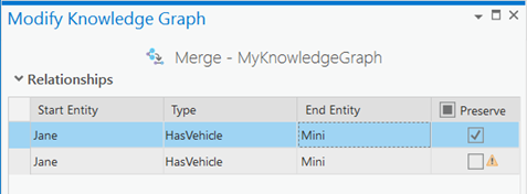

Merge relationships
Two relationships can be merged if the relationships connect the same entities. For example, you can merge many recursive relationships because they all reflect a relationship that an entity has with itself, but you would not be able to merge a recursive relationship and a relationship between the entity and another entity. If you are modifying a data model and combining multiple relationship types into one relationship type, merging different types and relationships with different directions is necessary.
You can choose how to handle the properties of the original relationships—deciding which values will be kept and which values will be discarded.

    The Modify Knowledge Graph pane appears. All selected relationships are listed under the Relationships heading. When you click a relationship, its properties are displayed under the Properties heading.
  3. Under the Relationships heading, in the Preserve column, uncheck any relationships you want to delete from the knowledge graph as part of the merge process.
    By default, all relationships will be preserved. To decide which relationship to preserve, compare the relationship properties using the table under the Properties heading.
    Choose which relationships you want to preserve.
  4. Click a relationship that will be preserved. Under the Properties heading, choose the property values that will be preserved with the relationship.
    When two relationships duplicate the same connection between two entities, you can choose which properties from those relationships you want to keep. Values of the preserved relationship are listed by default, but you can choose to keep a value from another duplicate relationship instead, or type in the value you want.
    1. Click a property value. A drop-down arrow appears.
    2. Click the drop-down arrow to see a list of all values for the property from all duplicate relationships.
    3. Click the value you want to use for the preserved entity.
    4. If you don't want to keep any of the existing values, type a value you want to use instead.
  5. Click Merge.
