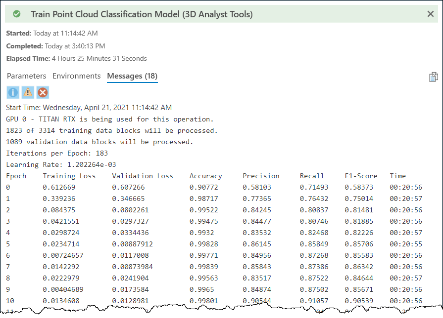

The tool also reports summary information per epoch while the tool is running. The time taken per epoch is also output, which will help you determine how long the process will take if all epochs are executed. You can see the metrics reported in the tool's messages. The Precision, Recall, and F1-Scores are averaged for all classes using an equal weight per class, a macro-average.
Example message output from training tool
An example of the message output from the Train Point Cloud Classification Model tool is shown.

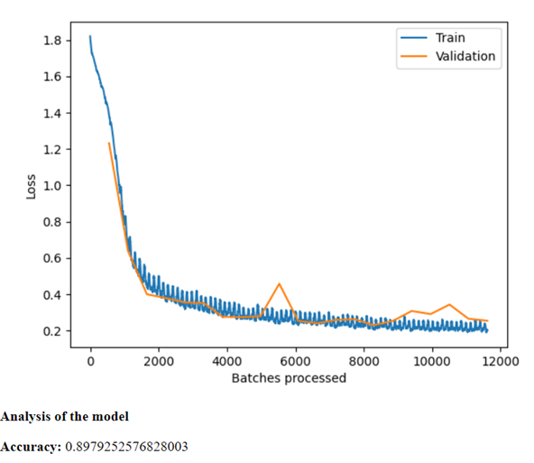

A graph of learning curves is also output by the training tool. It can be viewed in tool messages and is also written to the output model folder to a file named model_metrics.html. The graph includes loss curves for both training and validation. Lower loss is better, so you want to see curves that decrease over time and level off. Training loss shows how well the model learned, and validation loss shows how generalized the learning was.
Example graph of training and validation loss curves
An example graph of training and validation loss curves is shown.
You can check for under- and overfitting of the model by reviewing the loss curves. An underfit model is either unable to learn the training dataset or needs more training. Underfit models can be identified by training loss that is flat or noisy from start to finish or decreasing all the way to the end without leveling off. Overfit models have learned the training data too well but won't generalize to do a good job with other data. You can identify overfit models with a validation loss that decreases to a point but then starts going up, or leveling off, relative to the training loss. A good fit is generally identified by training and validation loss that both decrease to a point of stability with a minimal gap between the two final loss values.

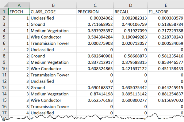

One is a * .csv text file called model_name_Statistics.csv that is placed in the output model folder. It contains Precision, Recall, and F1-Scores for each class per epoch.
Example output Statistics.csv file
The Statistics.csv file is exported from the Train Point Cloud Classification Model.
