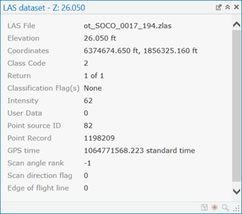

LAS dataset point pop-up information
When a LAS dataset or individual LAS/ZLAS file is displayed as points in a map or scene, you can select any point using the Explore tool and the lidar point attribute information in the graphic below will appear for the selected point. If the LAS dataset is displayed as a TIN in a map or scene, you can select any location on the TIN and elevation, aspect, and slope information will populate the pop-up window for the selected location.
LAS point attribute information

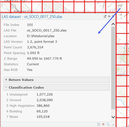

LAS/ZLAS file point pop-up information
When a LAS dataset or an individual LAS/ZLAS file is displayed using a wireframe to show file extents, you can select any file using the Explore tool, and the pop-up will display information for the selected file. The ability to view statistical information for LAS files referenced by the LAS dataset is essential to better understand the lidar data that you are working with. You can view general information in the pop-up, and then view a point count for the Return Values and Classification Codes that are available for the selected file. The ability to select the wireframe is only available in a 2D map view in ArcGIS Pro.
LAS file attributes
