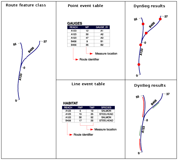

Event table example
Hydrologists and ecologists use linear referencing on stream networks to locate various types of events, as illustrated in the example below. The route feature class for streams provides measures along the streams using river reach mile. Point and line event tables record the route ID and location along each river reach. These event tables can be used to locate point and line events.
Line and point event table example
