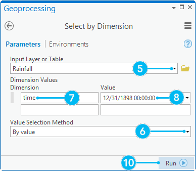

  1. Click the Analysis tab.
  2. Click Tools.
  3. Type Select by Dimension in the text box in the Geoprocessing pane.
  4. Click Select by Dimension in the returned list to open the tool.
  5. Click the Input Layer or Table drop-down arrow and select a netCDF layer or table from the list.
  6. Click the Value Selection Method drop-down arrow and select BY_INDEX to specify a dimension value by its position or index.
  7. Click the Dimension Values drop-down arrow and select a dimension from the list.
  8. Click the value field next to the dimension and select a value from the list, or type in the value if a list does not appear.
  9. Repeat steps 7 and 8 for other dimensions if necessary.
  10. Click Run.
