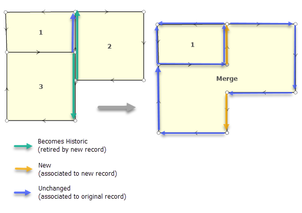

Parcel features are updated as follows:
  • Parcel lines that are no longer used by other adjacent parcels are retired as historic. These are often boundary lines between adjacent parcels being merged.
  • Parcel lines that partially define the parcels being merged and are in use by other adjacent parcels are retired as historic. New split boundaries are created for the merged parcels.
  • Shared boundaries that were not altered by the merge remain unchanged and associated with the original record that created them.
  • If parcels from different parcel types are merged, the original parcel features remain current and unchanged. The merged parcel is added to the parcel type layer selected in the Merge pane.
Merging parcels
Shared boundary lines are updated when merging parcels 2 and 3.
